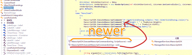

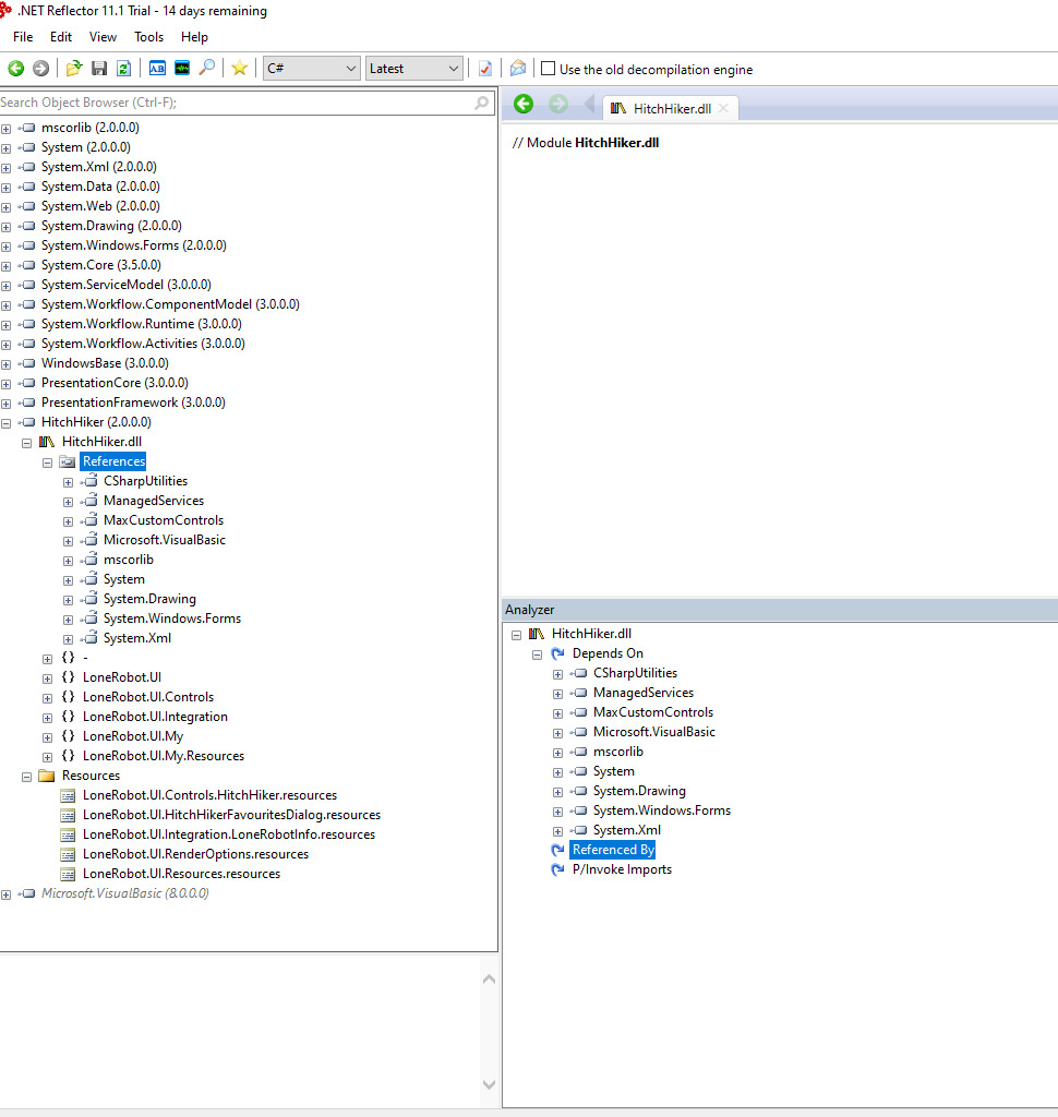

DLL is a library that has been encoded. How can I open its source code?
Decryptor
Some app can decrypt the dll. Dont know if the code is modifiable. I attached a decrypted screenshot. Btw, Can you make a new dll with similar functionality? they are not many.
