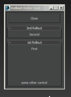

Panteleev Sergey
You can't add any control to floater window directly.
local rf
rollout zero_rollout "" height:15 category:0
	button toggle "Open" align:#center width:180 height:32 offset:[4,-6]
	on toggle pressed do
		for r in rf.rollouts where r != zero_rollout do r.open = not r.open
		if toggle.text == "Close" then toggle.text = "Open" else toggle.text = "Close"
rollout first_rollout "1st Rollout" width:150 category:2
	label rights "First"
rollout second_rollout "2nd Rollout" category:1
	label second "Second"
rf = newRolloutFloater "Rollout Order Test" 200 200
addRollout zero_rollout rf rolledUp:false border:false
addRollout first_rollout rf rolledUp:true
addRollout second_rollout rf rolledUp:true

Reply to Panteleev Sergey
titane357
Thanks for this exemple. But is there a way to change the panel size when opening or closing a rollout ?
Cheers
Reply to titane357
Panteleev Sergey
How do you set new floater size?
I have no 2019 nor 2018 to help you with it.
on second_rollout rolledUp state do
	if state then rf.size += [0,second_rollout.height] else rf.size -= [0,second_rollout.height]
