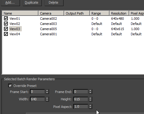

Sort Batch Render Cameras sequence by camera name
By compuhms · 2018-08-25
Comments (13)

compuhms
I'm using 3ds Max 2016, the script gives no errors but after running the script it JUST select all cameras and open the Batch Render dialog ONLY. Still cameras are not sorted. what do you think?
Reply to compuhms

miauu
Try this one:
	function SortByXMember arr1 arr2 x:1 =
		stricmp arr1[x] arr2[x]
	brmNumViews = batchRenderMgr.numViews
	if brmNumViews != 0 do
		viewsArr = for v = 1 to brmNumViews collect ( #(v, (batchRenderMgr.GetView v).camera.name) )
		qsort viewsArr SortByXMember x:2
		sortedViewsArr = for arr in viewsArr collect ( batchRenderMgr.DuplicateView arr[1] )
		for v = 1 to brmNumViews do (batchRenderMgr.DeleteView 1 )
	actionMan.executeAction -43434444 "4096"  -- Render: Batch Render Dialog Toggle
Reply to miauu
