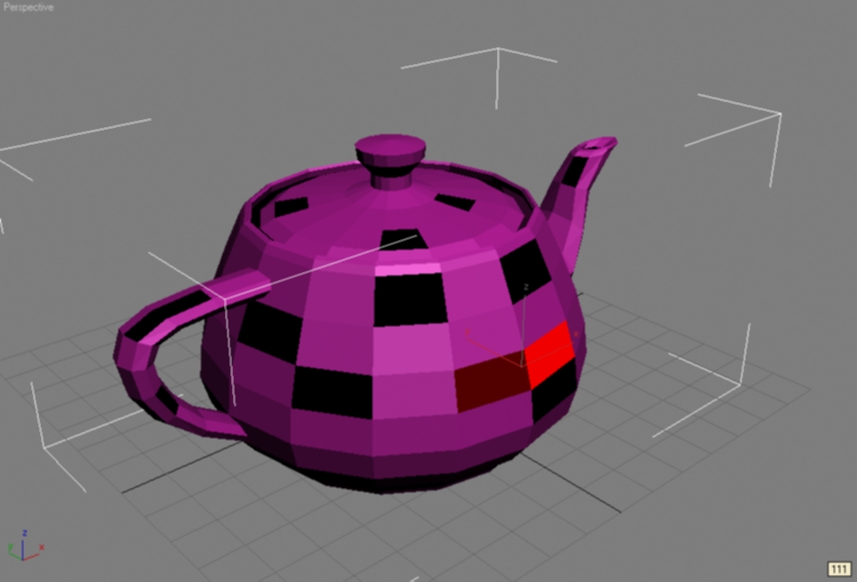

guys i need to correct all the polygons at once of any object.....and by correction i mean to flip the dark polygons to its correct form...
and i don't want to select polygon one by one.
i actually have a heavy mesh that needs to be correct its normals.
please help me guys,
i suggest you tot make a script that corrects or flip the normals to the user eye on the out side or flip the polygons to the outside world.
http://i37.tinypic.com/2luxshh.jpg

"unify" in the normals modifier can be affect if base object is editable_mesh.
if you working on editble_poly, first time you must add edit_mesh modifier and then add normals modifier, now "unify" is working correctly :) , ... so end operation just collapse the stack.
An alternative way to use a script without normals modifier, Please check the link below :
http://www.scriptspot.com/3ds-max/scripts/unify-flip-normal-polygons
hope it's help you
Budi

hmm, was a nice theory but the normals modifier kinda doesnt work >.<
btw is it an ePoly or a mesh?
