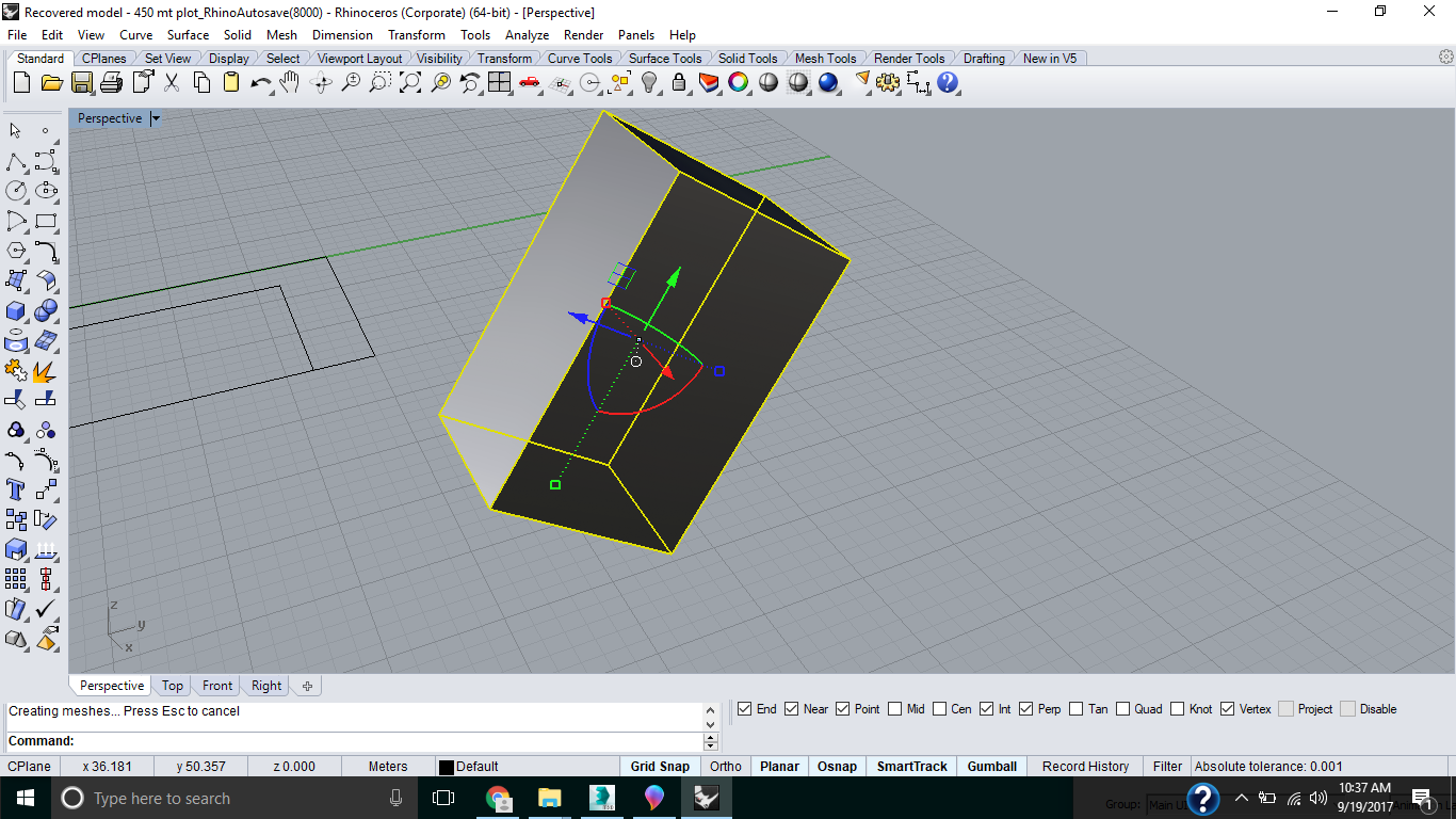

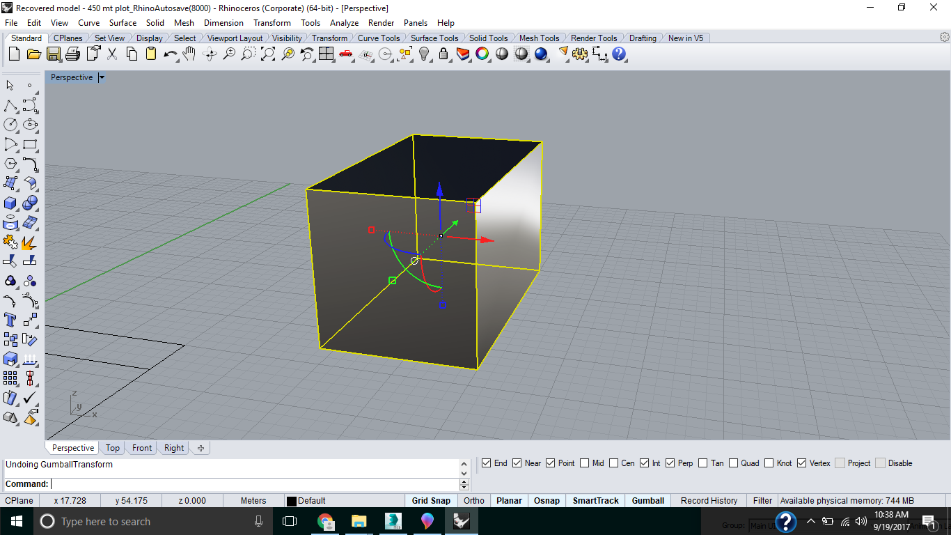

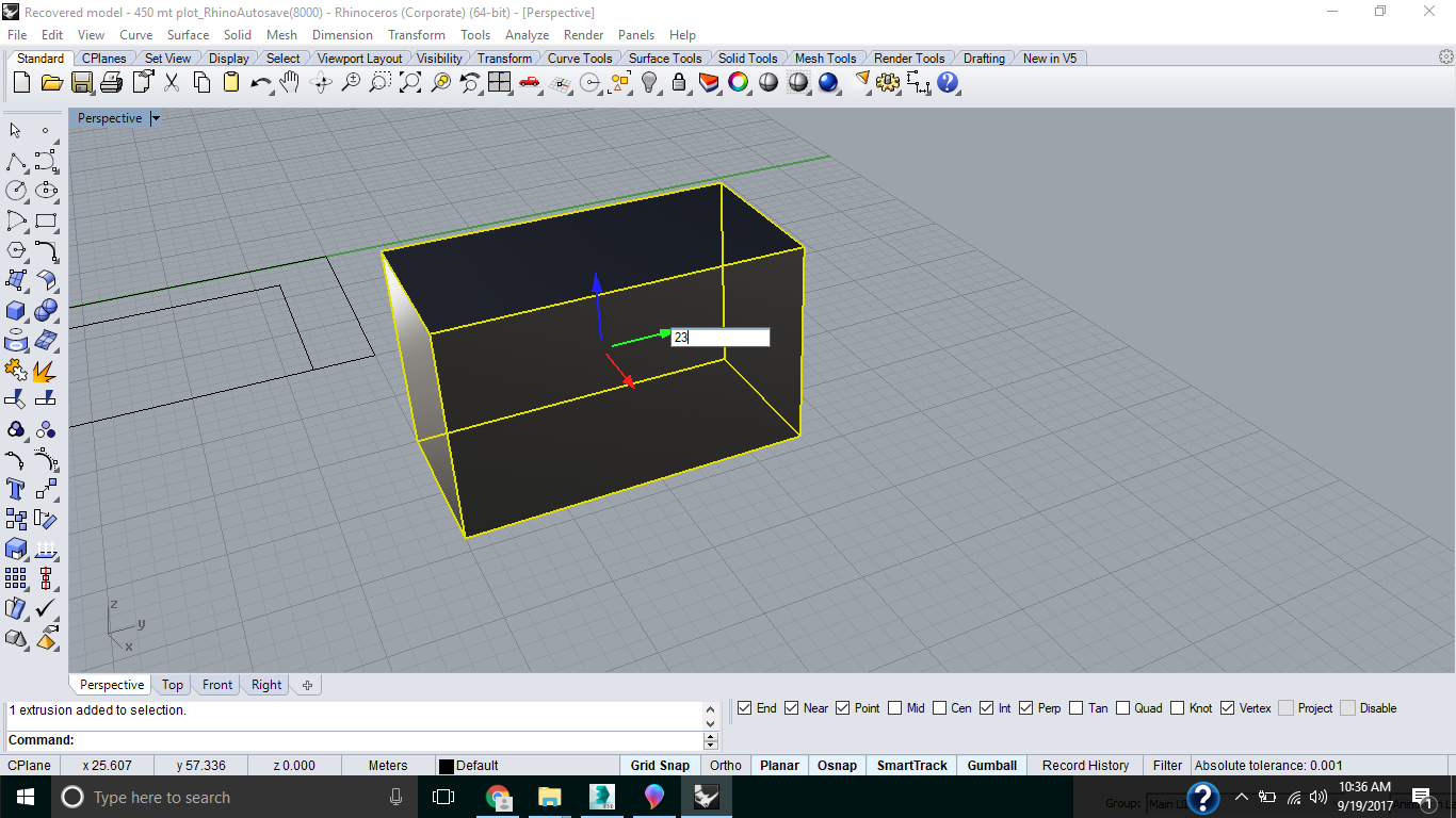

well can we move rotate and scale offset in viewport itself by clicking the xyz arrows and directly feed new coordinates in the viewport itself
like in rhino
i have attached pics for the better understanding of my point
thanks
viki

i knew every script of yours ;) and they are fantastic but i am very peculiar about this because i shifted from rhino to 3dsmax and this tool is called gimbal in rhino its so easy to model things in rhino because of its intuitiveness
can u make a script like this i am willing to pay sir

About the Gimbal in Rhino - this tool works all the time(I mean each time when you click an arrow of the gizmo the textbox where you can enter values apperas) or it have to be run from a hotkey?
