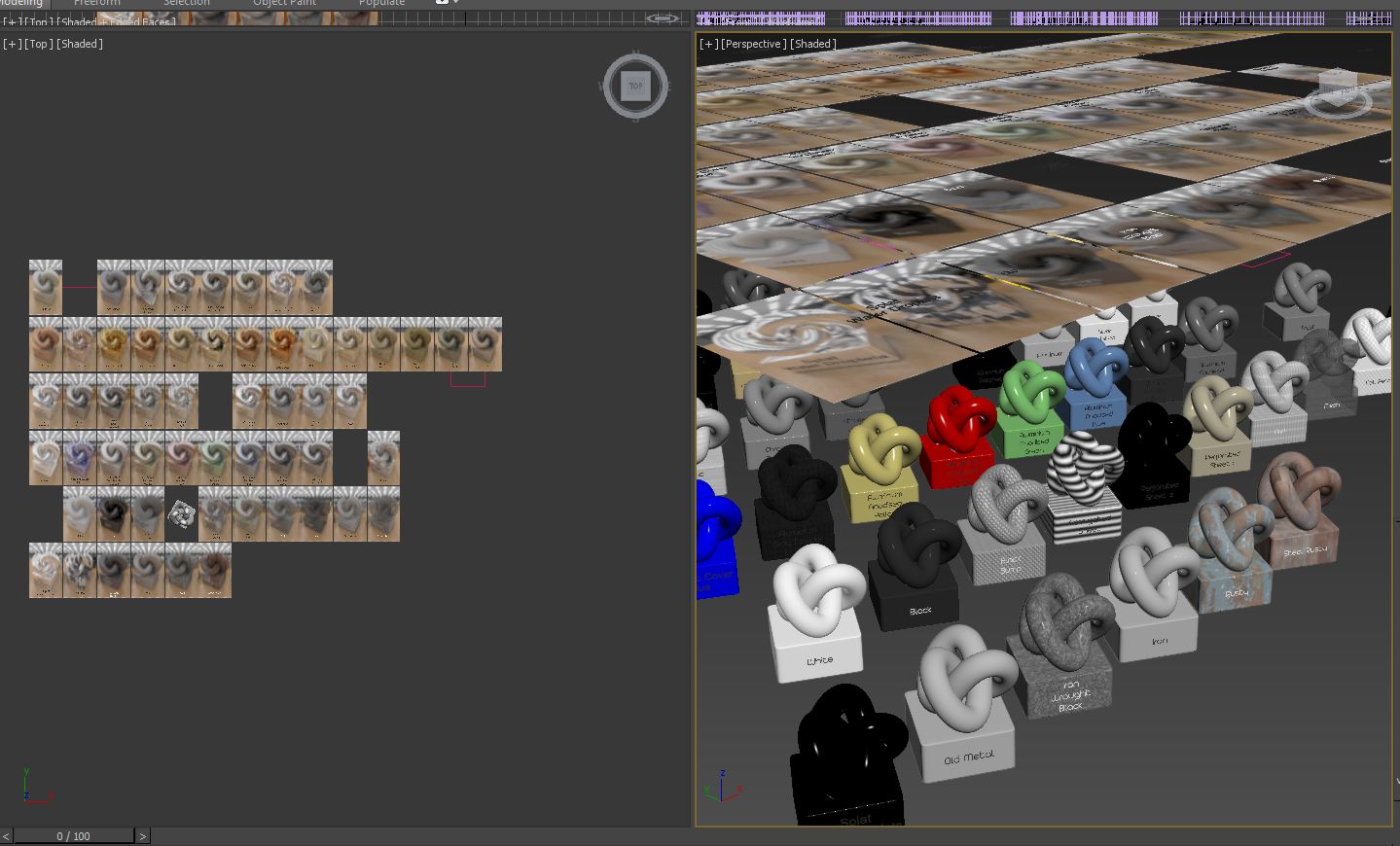

I'm looking for a 3ds max script that will allow me to copy an object's material (with a hotkey - don't like new menus and tool bars) and paste it to another object all within the viewport. It would save me a lot of steps having to first open material editor then pick the material then assign to new material. I would love something that did this between instances like CopyPasteObjects.mcr (best script ever :). It would save me so much time.
Attached is an example of what I want to do...to select the object with the mat I need, copy, then switch to different max scene and paste onto new object.
Right now I'm copying and pasting objects which is adding in a lot of unnecessary steps.
