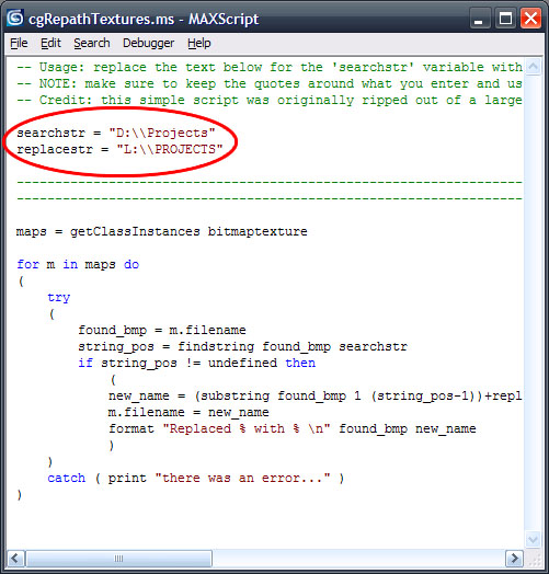

I had to do the exact same thing today. Its not the easiest script to use as I never bothered making a UI for it but its really easy to adapt to your needs. You just edit the script and replace the search string \\Network1 and the replace string with \\Network2 ... I've attached the script to this message.
So to use this go to Maxscript / Open Script and select this script from wherever you downloaded it. You'll see where I've pre set the script to look for "Network1" (quotes aren't being searched for, they tell 3ds to search for the text between the set of quotes) and replace with "Network2".
Recently I changed drives and folder structure so I put "D:\\Projects" in the searchstr and "X:\\3dsmax\\Projects" into the replacestr. Note the usage of double backslashes - they're required.
I've included a JPG showing part of the script that you'd need to edit just to be safe. Good luck.
