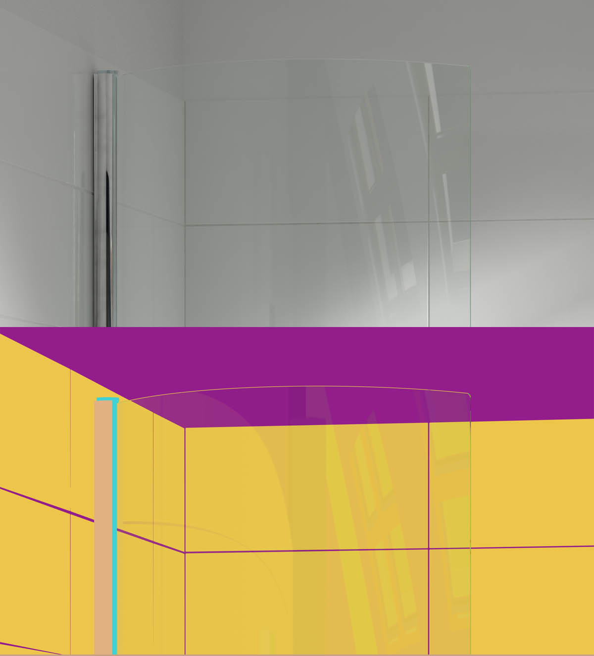

Currently the script is used to convert a scene into solid colours per material. The rendered output is then used by the post production dep. What we are doing manually is converting all the glass materials (and alike) back to glass.
This is so that when glass objects cover another object, the channel render shows what is seen through the glass.
So, I am trying to get the script to basically ignore the mats that have transparency so they render the colours beyond them.
I hope that makes sense. Let me know if not.
I have attached an example of where this occurs.
