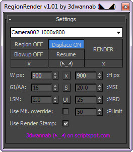

What I'm missing from the functionality is:
- I want the default text of the Combobox to be 'Choose Camera...' with a list of camera which I already have below.
- Renaming of the selected camera directly inside the ComboBox. Tabbing or hitting return will rename the camera.
- If I change a spinner/s it will rename the selected camera. (See screenshot of script)
- If I tab out of the ComboBox then it will go over to a spinner
- When a camera with correct formatted name i.e 'cam name 1000x600' whereby cam name is what you think and the 1000x600 is the dimensions of the output inside max. (not VRays framebuffer)
