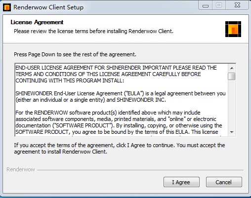

2) Once the dialog shown below appears, click “I Agree” button.

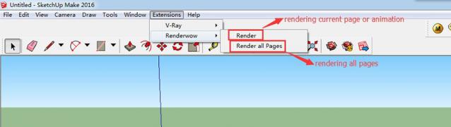

3) Submitting jobs though the cloud rendering service. Click Extensions --> Renderwow --> Render. As shown in the picture below:

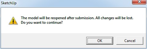

4) Reopen model warning box. As shown in the picture below: Renderwow will open the model after submission, all changes will be lost. Do you still want to continue? If yes, please click “yes”; if you need to save it first, please click “cancel” to stop submitting.

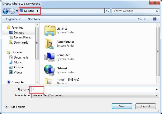

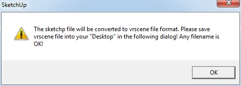

5) As the saved file shown in the dialogue below, please click “yes”. The file explains that SketchUp file will be converted to vrscene file format, please save vrscene file into your “Desktop” in the following dialog! Any filename is ok!
6) Save vrscene file. Please note: Save the file into “desktop” and any files name is ok like “1” as shown in the pic below.

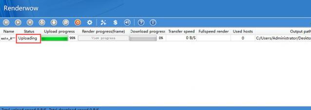

As shown in the screenshot above, renderwow’s processing stage and estimated time are shown on the right bottom status bar. For this moment, you don’t need to do anything but waiting. Please note: Please be patient to wait! For complex model, the processing time will be longer. You can continue to operate SketchUp after the plugin submitted successfully; Otherwise it is easy to make SketchUp dead influencing submitting process.

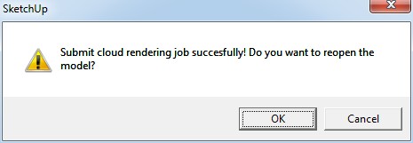

7) The following dialogue will be shown after the job submitted: Please click “yes” if you need to open the model and click “cancel” to close the model according to you requirements. As shown in the picture below:
You will see the job you submitted after having login successfully on Renderwow.

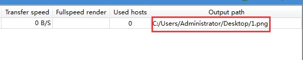

8) You need double-click “Renderwow” output path to see the rendering result. As shown in the pic below:
