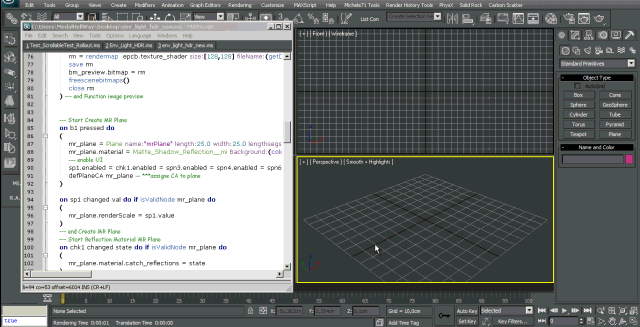

hi all man and thanks for and thanks for the visit :)
I have completed another script and I'm completing the final steps (debug and more options). Now it is a problem. The script provides for the creation of a obj plane "general" called mr_plane and a map environmet. With its creation of plane (and map env), I active every spinner etc .. because I want it to be created first. Now If I close the rollot and re-open it, the spinner ecc are desabled. I know many ways to refresh parameters ecc, but are now bogged down..
My question is:
How to recognize the presence of the plane (and evironment) and activate all parameters? The problem is if the plane is renamed AFTER its creation and if there exists a map environment different or equal...
Any suggestion is welcome! Thanks!!
P.S: I attach the script to be consulted :)

Ok, continue to update the discussion :) I found a way around the problem with the material editor:
for o = 1 to 24 do
if superclassof meditmaterials[o] == texturemap and classof Environment_Probe_Chrome_Ball__mi == texturemap do
meditmaterials[o] =standardmaterial()
Now all work well and the script is almost finished, but...
When I close the rollout or reopen, the preview image appear even if I removed the CA and textureMap in the environmet. If I evalute this string:
envArr = for m in sceneMaterials where isProperty m #epcb_ca collect m
I have as a result:
#(Environment_Probe_Chrome_Ball__mi:Environment Probe/Chrome Ball (mi))
but I delete all!!
However, the strange thing is that if I wait a few minutes with the rollout closed,the described situation disappears !! All work well...
Why the textureMap remains in memory for a long time even if canceled?
Attach the script if you want to consult :D
