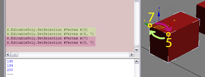

I "made" a simple script to align poly vertexes to first selected vertex.
But it don't align (always) to first selected vertex...
Dummy is just here to see which vertex is taken for align...
Please if somebody can help....

titane357
hi Anubis,
Perhaps for Objects Max keep right order, but if you take a look to the .png, you will see that if I select vertex #5 then vertex #7 or in reverse order, resulting array is the same : [5,7] :-(((

titane357
hello
Thanks for help,
But in fact after testing, I saw that "selectedVert[1]" is not the first selected vertex but the first vertex in the array which 3dsMax reorder in growing order....
How can I tell Max to return me the first selected vertex ?
