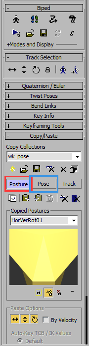

I would like to put the biped sports panel copy / paste under the posture and pose button into my own plug-in, but I do not know the two buttons to achieve what the code is, please help me, thank you
By perfectwk · 2016-12-29
Open the maxscript help file and search for:
Biped Copy and Paste Posture Methods
