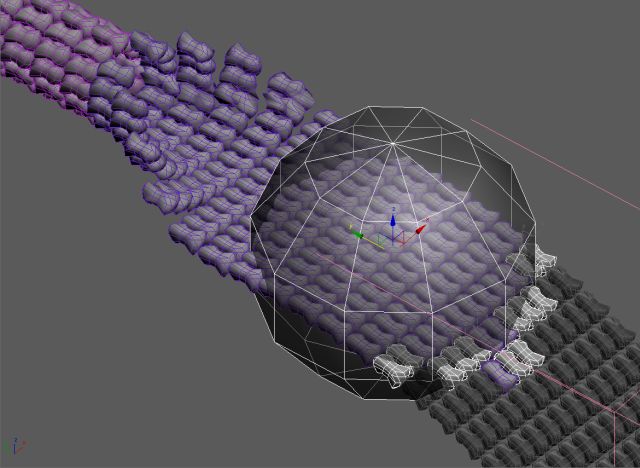

Hi all,
Is there a way to connect an object´s transform (M/R/S)to other object´s visibility and modifiers? In the attached image, a sphere moves (-Y axis)in an array of objects. 1- As it touches each object, they became visible (those in white). 2- Then, some rows behind, each row begins to fold into a ring (those in magenta). In 1-, the simple (and draft) way is to link the sphere movement to each object, by comparing their Y position (in natural language: if Y of sphere is greather than obj Y, then obj is visible). This is without checking surface intersections ofcourse, but never used script before and seems I cannot script even that simple rule.
In 2-, all the row has a parametric bend modifier that could be set in the same way (as the sphere passes), but for now is animated by hand. So, I thanks in advance those who are kind enough to spare some time and help me in this matters (and excuse my english).

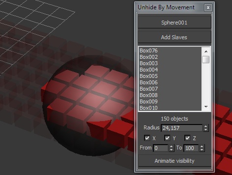

"Fade in over .. frames" added. this is the number of frames it takes before it's totally visible. So you can create a fade-in effect.
So how it works:
- pick control object. can be any object. If you pick a sphere the radius will be autotaken
- set radius.
- choose axes
- choose over how much frames it has to fade in. If you dont want this, just set this to 0
- choose time range
- press Animate visibility
I'll will expand this script later and post it. future plans. (hide or unhide, fade back out over a choosen time, center visibility so in the center total visible and at the ends less visible, ...) hope for user requests!

Howerer, it seems to be something uncompatible (could be the 3dsMax v.9?) When I click "Add Slaves" (having selected objects),
got an exception:
"Type error: Call needs function or class, got undefined"
at this line:
"for obj in selection do appendIfUnique ListOfObjects obj"
When none is selected, clicking the "add slaves" button have no action.
jos · 2012-06-18
hmm I guess the appendIfUnique method isnt supported in max9. I'll make an update tommorow.

first version
jos · 2012-06-16
So this is the first version (no error checking, and if the sphere passes it sets one keyframe). Check out if this is what you need. If you need additional features (fade in over a certain frames for example, just ask). For the addition of the bend modifier i'll make a version just for you, can you provide me with a max scene as example? it's difficult to know which angle I have to animate an over how much frames. So if you give me a max file and specific info I'll do the job for you.
