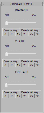

I modified it a little...just to complicate my life...
- "DELETE ALL KEY" now put value to zero
- I added a slider with automatic keyframing on currentTime
- I also added buttons to add exact value keyframe on currentTime
Did I worked well?

Reply to stefano
Branko Živković
Yep. You complicate your life with a slider.
I will probably use Checkbutton control
checkbutton cb_animstate "Animate On/Off" highlightColor:[150,20,20]
on cb_animstate changed state do animButtonState = state
Yes, but I like hard things, and with autokey I can save a lot of clicks :)
Maybe, do you know how to set In/Out Tangents to AUTO for created keys?
I tried with inTangentType = #auto but with no luck!

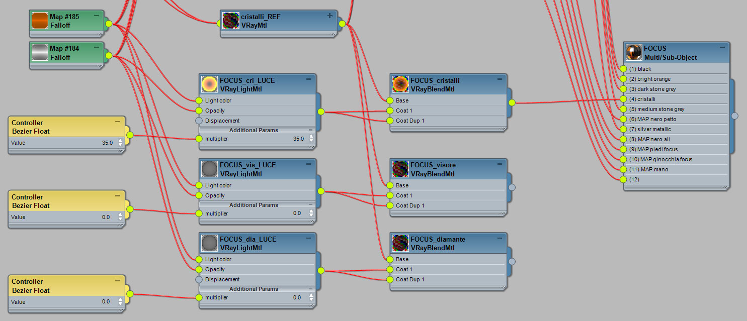

I fixed the code by testing these tree materials which are nested inside Multimaterial, VrayBlendMtl and VRay2Side. Also works inside other materials also.Check again my last code.

The updated version works fine, it shows me all vraylightmtl in the scene... but my script continue to give me the error, ahahh!
Another way I tried was to add variables for material name, something like this:
 local RABdia = scenematerials["RABBIT_diamante"].coatMtl[1]
 local RABvis = scenematerials["RABBIT_visore"].coatMtl[1]
 local RABcri = ???????
 rollout rabbit "CRISTALLI RABBIT" width:162 height:400
  label rabbit_dia_lab "DIAMANTE" pos:[55,8] width:50 height:15
  slider rabbit_dia_sli "Off                              On" pos:[14,28] width:136 height:44 range:[0,35,0] type:#integer orient:#horizontal ticks:10 animatable:true controller: RABdia.multiplier.controller
It works fine for VISORE and DIAMANTE, that are vrayBlendMtl, but no way to make CRISTALLI to work, because this is a vrayBlendMtl in a MultiSubobjMaterial.

because FOCUS_cristalli is in fact a submaterial of FOCUS.

But now I have to play with them...
If I go on with this
plugin modifier TEST
classID:#(0x133067, 0x54378)
version:1
 allVRayBlendMtls = getClassInstances vrayBlendMtl target:rootScene
 TEST = #(allVRayBlendMtls)
 TEST[1] = a
 rollout test "TEST" width:162 height:400
  label test_lab "DIAMANTE" pos:[55,8] width:50 height:15
  slider test_sli "Off                              On" pos:[14,28] width:136 height:44 range:[0,35,0] type:#float orient:#horizontal ticks:10 animatable:true controller: a.multiplier.controller
  button test_CK "Create Key" pos:[5,85] width:65 height:15
  button test_DK "Delete All Key" pos:[70,85] width:85 height:15
  on test_sli buttondown do
   ( ( animButtonState = True
    addNewKey a.multiplier.controller currentTime ) )
  on test_sli buttonup do
   animButtonState = False
  on test_CK pressed do
   ( addNewKey a.multiplier.controller currentTime )
  on test_DK pressed do
   ( deleteKeys a.multiplier.controller #allKeys )
I get an error... :(

Mmmm... good idea, but as a newbie I'm doing sometingh wrong...
try(destroyDialog ::test)catch()
rollout test "TEST"
	TEST[1] = a
		label test_lab "DIAMANTE" pos:[5,8] width:50 height:15
createDialog test 200 300 10 110 style:#(#style_titlebar, #style_sysmenu, #style_toolwindow)

stefano
Yep,
obviously in my original scene the material is assigned.
In the new one the material should be imported, but I receive the error even if I assign it to my object, and if I delete and reapply my script.
I'm going crazy about it... I'm quite sure there is some issue with material path name, but I can't find the bug :(
I'll attach a sample scene and the whole script if someone wants to try...
Branko Živković
You need to assigne this material to some object. That's why you recive error
