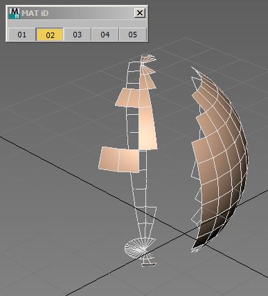

titane357
thanks, I already have it but I want to make something different.
I have used Lightwave for a long time and I want to have something like its layer management (like smoothing groups panel in max)
here is an example with 5 matid, I want to make rows of 10 ids...
