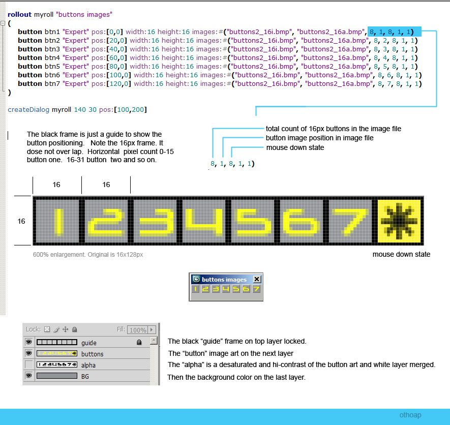

othoap
Button templete
joker,
I notice your spacing was not even. Each button image should be spaced every 16 pixels.
I hope this helps. If not send me the art.
miauu
I use only max2009 and all images for toolbar buttons are .bmp(color images and alphas).
One suggestion - go to maxroot/ui/icons and get, for example, Xrefs_a.bmp and Xrefs_i.bmp. Open them in photoshop and draw your new icons. Replace the original Xrefs_a.bmp and Xrefs_i.bmp(make backup befor doing that) and use them in your code.

miauu
The mask is wrong. The white area must be black and the black must be white.
