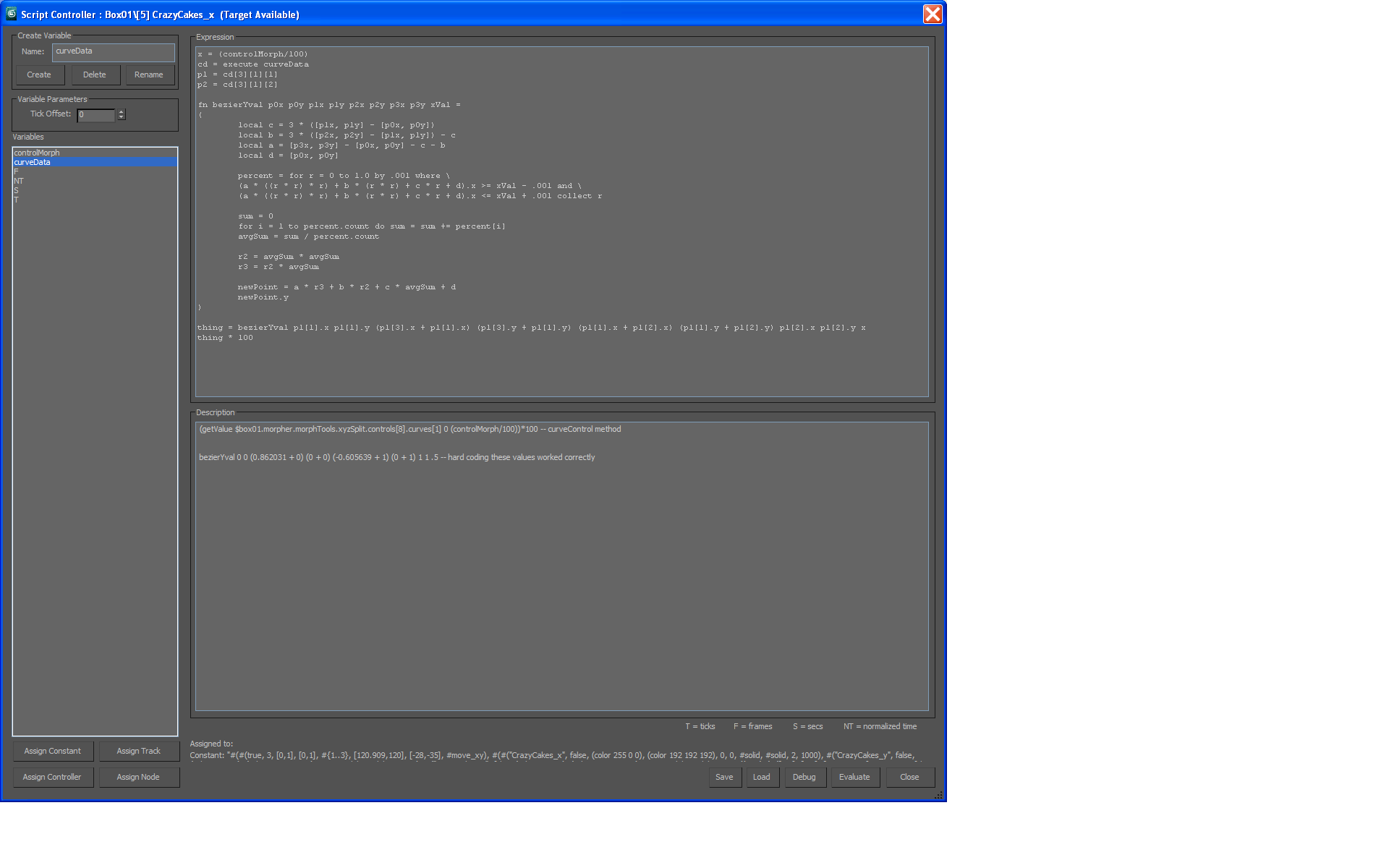

Oh, cool, you're almost there then. That's an easy. Here is a very very simple example - see the screeen shot.

Almost there! But I can only get it to work when I hard-code the values. As soon as I try to use variables from the scene it starts throwing **unknown system exception** errors.
-- Error occurred in bezierYval()
--  Frame:
--   r2: undefined
--   newPoint: undefined
--   avgSum: undefined
--   xVal: 0.399926
--   p0x: 0.0
--   a: [2.58609,0]
--   d: [0,0]
--   sum: 0
--   r3: undefined
--   c: [2.58609,0]
--   p0y: 0.0
--   p1x: 0.862031
--   p1y: 0.0
--   p2x: 0.0
--   p2y: 0.0
--   p3x: 0.0
--   p3y: 0.0
--   b: [-5.17219,0]
--   percent: #()
--   called in anonymous codeblock
--  Frame:
--   p1: #([0,0], [0,0], [0.862031,0], true, true, false, false, true, false, true)
--   t: 2560.0
--   NT: 0.16
--   thing: undefined
--   x: 0.399926
--   this: Controller:Float_Script
--   curveData: "#(#(true, 3, [0,1], [0,1], #{1..3}, [120.909,120], [-28,-35], #move_xy), #(#("CrazyCakes_x", false, (color 255 0 0), (color 192 192 192), 0, 0, #solid, #solid, 2, 1000), #("CrazyCakes_y", false, (color 0 255 0), (color 192 192 192), 0, 0, #solid, #solid, 2, 1000), #("CrazyCakes_z", false, (color 0 0 255), (color 192 192 192), 0, 0, #solid, #solid, 2, 1000)), #(#(#([0,0], [0,0], [0.862031,0], true, true, false, false, true, false, true), #([1,1], [-0.605639,0], [0,0], true, true, false, false, false, false, true)), #(#([0,0], [0,0], [0,0], true, true, false, false, false, false, true), #([1,1], [0,0], [0,0], true, true, false, false, false, false, true)), #(#([0,0], [0,0], [0,0], true, true, false, false, false, false, true), #([1,1], [0,0], [0,0], true, true, false, false, false, false, true))))"
--   f: 16.0
--   s: 0.533333
--   controlMorph: 39.9926
--   CD: #(#(true, 3, [0,1], [0,1], #{1..3}, [120.909,120], [-28,-35], #move_xy), #(#("CrazyCakes_x", false, (color 255 0 0), (color 192 192 192), 0, 0, #solid, #solid, 2, 1000), #("CrazyCakes_y", false, (color 0 255 0), (color 192 192 192), 0, 0, #solid, #solid, 2, 1000), #("CrazyCakes_z", false, (color 0 0 255), (color 192 192 192), 0, 0, #solid, #solid, 2, 1000)), #(#(#([0,0], [0,0], [0.862031,0], true, true, false, false, true, false, true), #([1,1], [-0.605639,0], [0,0], true, true, false, false, false, false, true)), #(#([0,0], [0,0], [0,0], true, true, false, false, false, false, true), #([1,1], [0,0], [0,0], true, true, false, false, false, false, true)), #(#([0,0], [0,0], [0,0], true, true, false, false, false, false, true), #([1,1], [0,0], [0,0], true, true, false, false, false, false, true))))
--   p2: #([1,1], [-0.605639,0], [0,0], true, true, false, false, false, false, true)
>> MAXScript Script Controller Exception: -- Unknown system exception <<
As you can see from the error readout it looks like everything is working except the for loop, which is no longer collecting any values for some reason ( -- percent: #() ) ???
Man, they sure don't make this easy. Did I mention that I hate the curveControl UI?
I'm attaching a screen shot of my script controller too.
Reply to pacermike
Panayot Karabakalov
Maybe need to start reply on top
This for-loop kill the whole function. With empty array the line: "avgSum = sum / percent.count" is evalueted as dividing zero by zero that for sure is a system exception.
Realy strange... the for-loops itself works fine in script controllers...
Sigh :(
