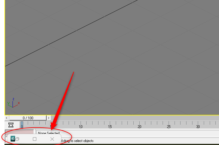

Hello gentlemen,
I have a hard time with my 3ds Max 2009 every time I open the software it always starts with the maxscript dialogue box open. I would like to know if there is a way to start the 3ds max without the maxscript dialogue box open.
I have tried to uncheck the load startup scripts under MAXscrips but didn't work.
Please any help solving this little thing with be appreciated.
Thanks,
Linkitch
It's part of the UI settings.
Close the dialogue box and then close Max and wait until it is fully closed and has saved the UI. Then reopen max and it should no longer open.
