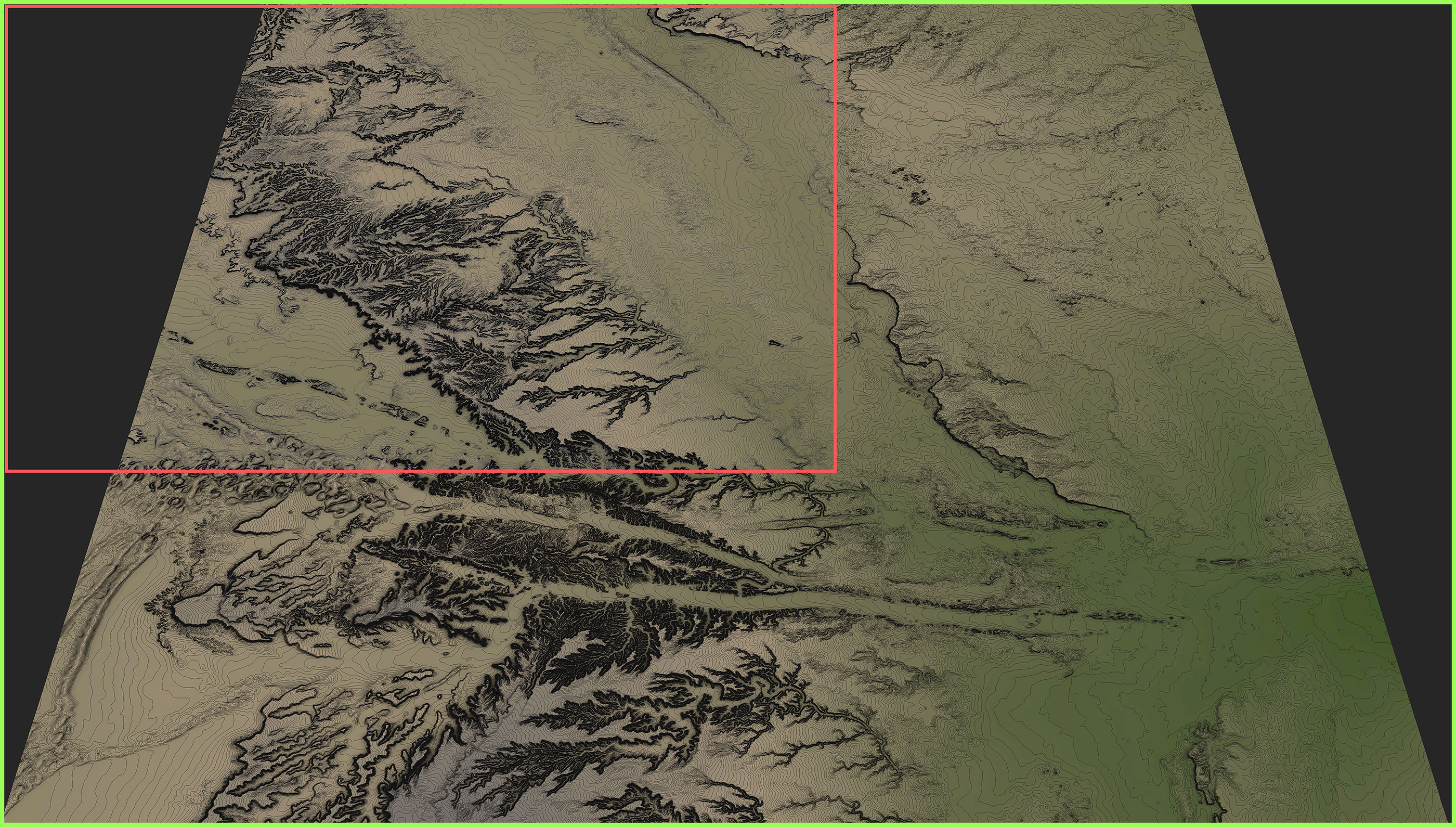

Thank you very much for your efforts. I recently had a chance to test the script, but unfortunately, it doesn't work as expected. Please refer to the attached screenshot for a detailed explanation.
- Within the green frame is a 7500px screenshot (the maximum for the grabviewport2.mcr script). This is the correct output when a fully maximized viewport is saved.
- Within the red frame is the screenshot generated by your script. Although it is 7680px, it captures only a part of the screen. Unfortunately, the maximized viewport is truncated and upscaled before saving.

I've removed the part of the script that hides Statistics, World Axis,etc...and used Miauu output naming approach. For the cropping problem , i don't understand whats going on because on my side it grabs the all view without any cropping, try this version:

If the cropping problem remains, it might be related to screen resolution , do you have a 4k screen? I think there is some sort of UI scaling when 3dsmax runs on a 4k screen, i might need to check if something in "grabviewport2.mcr" script was there to prevent this problem.
Let me know if it worked or if i need to investigate further...
