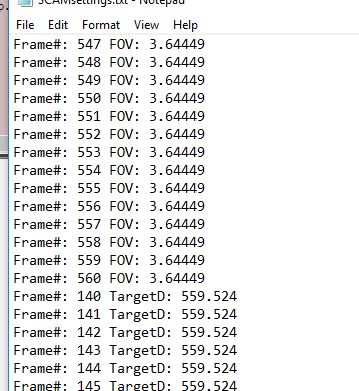

Strange. I expanded the time range.
The Target distance works fine, but the .FOV repeats whatever frame I'm currently at. I restarted max and the file, same results.
(purpose. I'm animating the FocalLength and Zoom only. In doing so, I want to capture the .FOV reading per frame.)
for i=165 to 560 do at time i (
format "frame: % fov: %\ttarget distance: %\n" i $.fov (distance $ $.target)
Results:
frame: 165 fov: 3.65129 target distance: 564.072
frame: 166 fov: 3.65129 target distance: 564.058
frame: 167 fov: 3.65129 target distance: 564.041
frame: 168 fov: 3.65129 target distance: 564.023
frame: 169 fov: 3.65129 target distance: 564.005
frame: 170 fov: 3.65129 target distance: 563.987
frame: 171 fov: 3.65129 target distance: 563.969
frame: 172 fov: 3.65129 target distance: 563.953
frame: 173 fov: 3.65129 target distance: 563.94
frame: 174 fov: 3.65129 target distance: 563.929
frame: 175 fov: 3.65129 target distance: 563.922
Reply to Kelley
Panteleev Sergey
try this
for i=165 to 560 do (
        sliderTime = i
