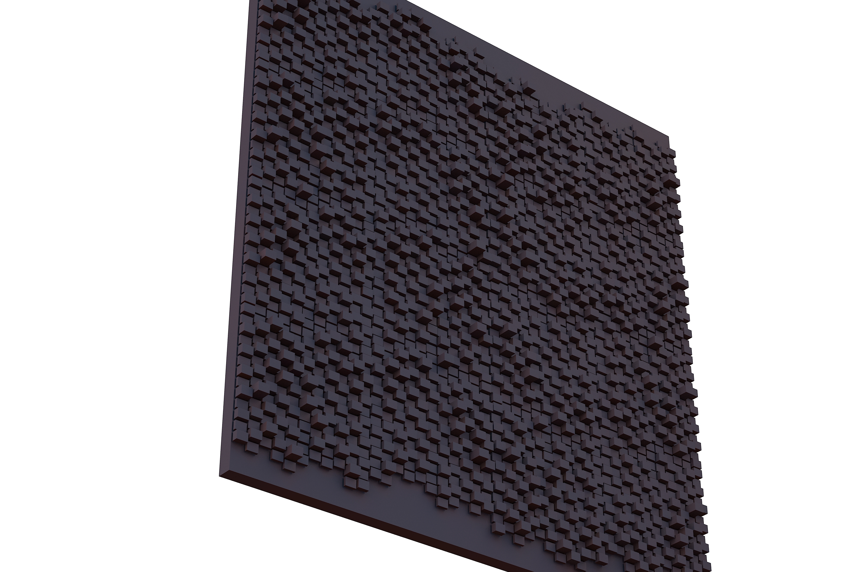

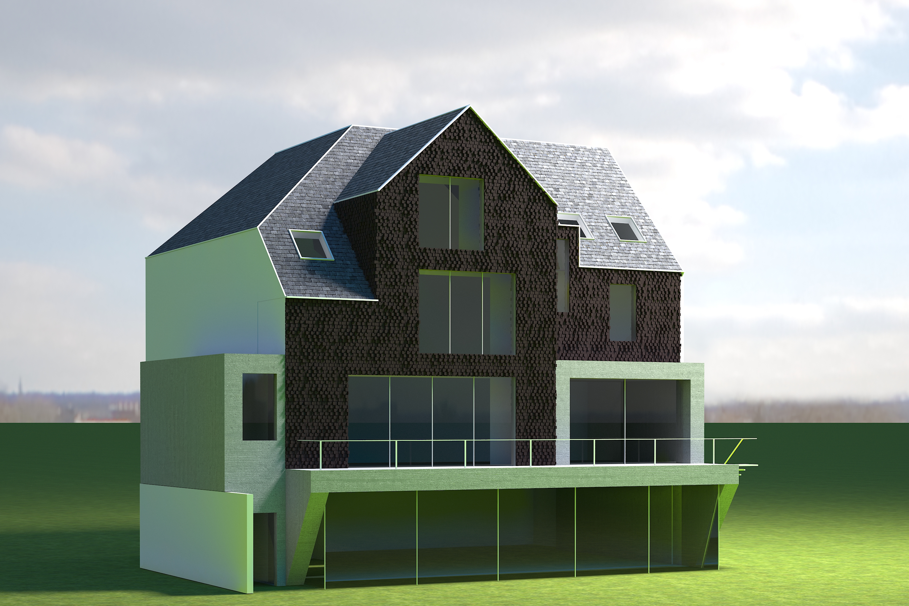

Hi I'm making this brick facade that is supossed to be like a wave surface combined with randonly extruded brick (see attachemnt) at this momment it is a modelled cluster of 10x10 brick, instanced, rotated and copied around. But no flexibility - I would like to be able to locally control the amount of extrusion parametrically or by a density map. I don't think displacement is the optimal way to do this. Does anyone know if there is script that would help me?
Cheers
Matej
Not sure if it'd be flexible enough for your needs but the example reminds me of the "pinscreen" script. http://www.scriptspot.com/3ds-max/scripts/pinscreen
