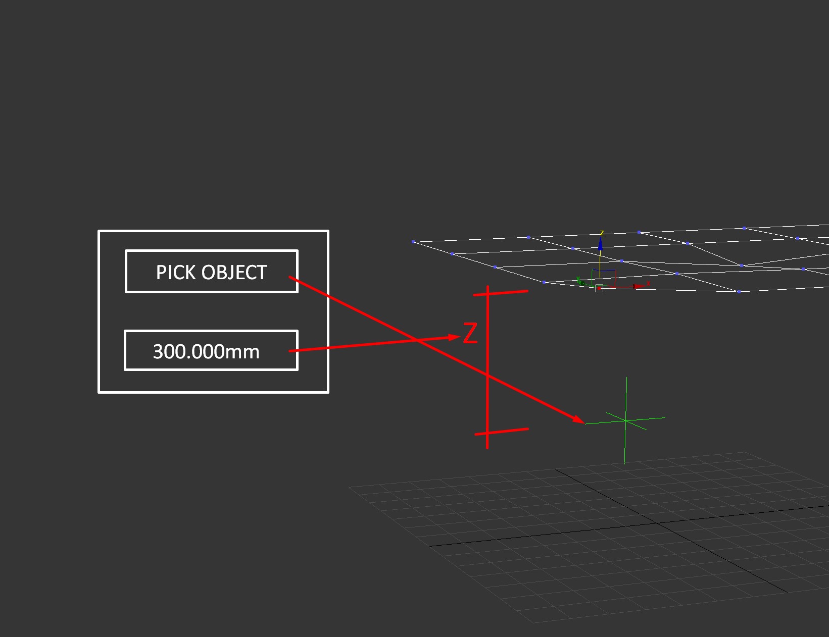

Hello everyone! I don't understand scripts. Please help me make a script if it's not difficult: so that it interactively shows the distance along the Z axis from the selected object (help point) to the selected vertex (editable poly). This used to work with Working Pivot, but now it doesn't work at the subobject level.
Distance along the Z axis from the selected object

You can find the script here:
https://www.mediafire.com/file/hteyrxh21ozxpvw/SimonScripts_Vertex_Z_Pos…
If you have multiple vertices selected it will use the average Z position.
