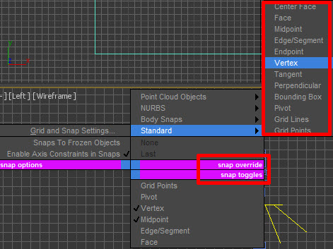

Hi guys, Shift+RMB brings up a menu to enable snap override.
I enable midpoint and vertex as defaults and any time I need anything else I do this.

miauu
I had the idea to write such a script. :)
I already hava all the code that I need. Just have to put the parts together. :)
Some of my scripts in Script Pack vol.2 automatically turns off all snap options and turns ON only the snap to Vertex. When the script(the user) finish its job, all snap options are restored at their initial states(before to run the script).
Note that some external plugins(for example powerNurbs) adds its own Snap options which may/will change the default snap settings.

This function works for max2014
fn setSnapMode name: state: =
case name of
"Grid Points": snapmode.setOSnapItemActive 4 1 state
"Grid Lines": snapmode.setOSnapItemActive 4 2 state
"Pivot": snapmode.setOSnapItemActive 5 1 state
"Bounding Box": snapmode.setOSnapItemActive 5 2 state
"Perpendicular": snapmode.setOSnapItemActive 6 1 state
"Tangent": snapmode.setOSnapItemActive 6 2 state
"Vertex": snapmode.setOSnapItemActive 7 1 state
"Endpoint": snapmode.setOSnapItemActive 7 2 state
"Edge/Segment": snapmode.setOSnapItemActive 7 3 state
"Midpoint": snapmode.setOSnapItemActive 7 4 state
"Face": snapmode.setOSnapItemActive 7 5 state
"Center Face": snapmode.setOSnapItemActive 7 6 state
max drawingaids; max drawingaids
-- check vertex checkpox
setSnapMode name:"Vertex" state:on
-- uncheck grid points checkbox
setSnapMode name:"Grid Points" state:off
