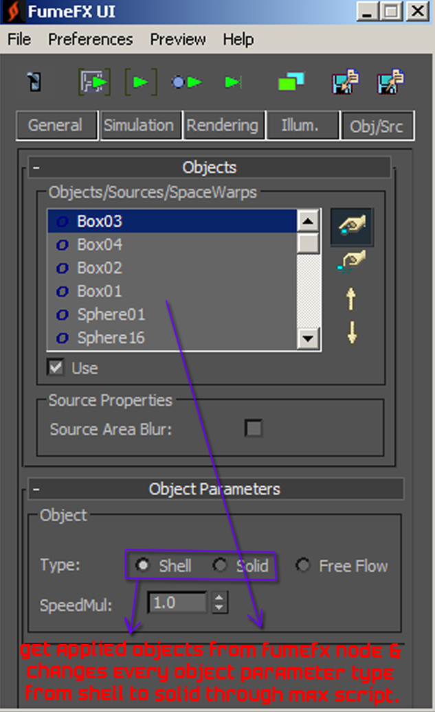

 Dear All
          I am attaching the image of full detail about my requirement. I am trying to get applied objects from the fumefx object, I didnt find any method.
The fumefx object properties are as follows, If anybody have solution please help me.
show $
