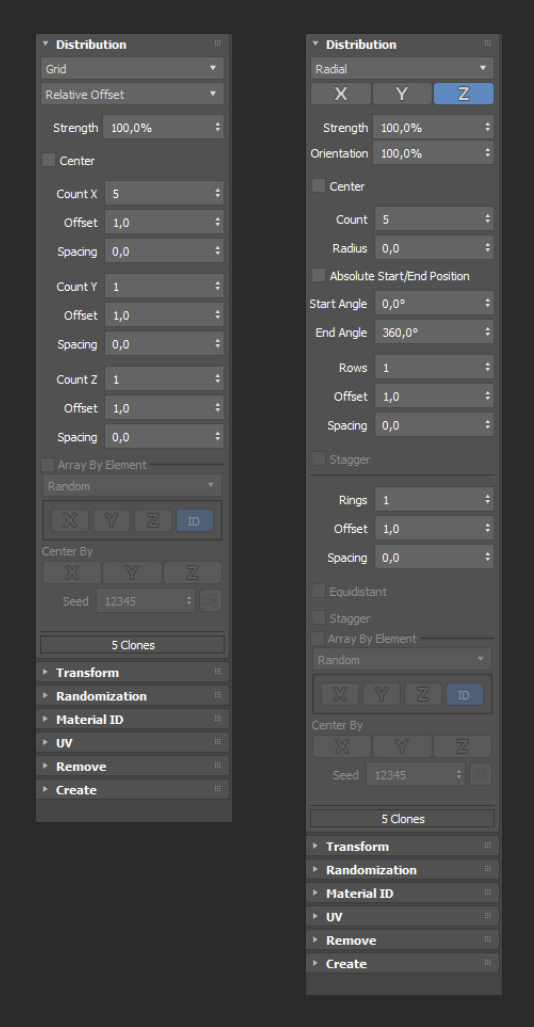

I am trying to build a dynamically rebuilding Custom Attribute UI in MAXScript, similar to how the standard Array modifier works.
More specifically, I want behavior like the Distribution rollout in Array: when the top dropdown changes, the whole visible set of controls below it changes immediately, the rollout height updates, and the rollouts below move accordingly — without leaving an empty vertical area, and without looking like a visibly nested subrollout.
I attached an example of the 3ds Max Array modifier UI showing the desired behavior.

Is there a way in pure MAXScript to make a Custom Attribute rollout rebuild itself in place like the standard Array modifier’s Distribution rollout?
Or is that behavior only possible through an internal / SDK-based UI mechanism that is not available to scripted rollouts?

It is possible in rollout,but i didn't test in Custom Attribute
Hello Vadim,
i think you can do that by using some position coordinates that aren't visible and use event to move them, here is an example for classic rollout:

Edit: in custom attribute it isn't as easy as .height isn't exposed, the only way i found is to use subrollout, and to rebuild them each time, here is an example:
